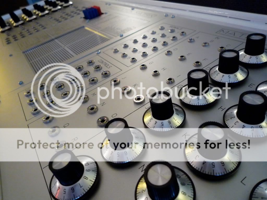

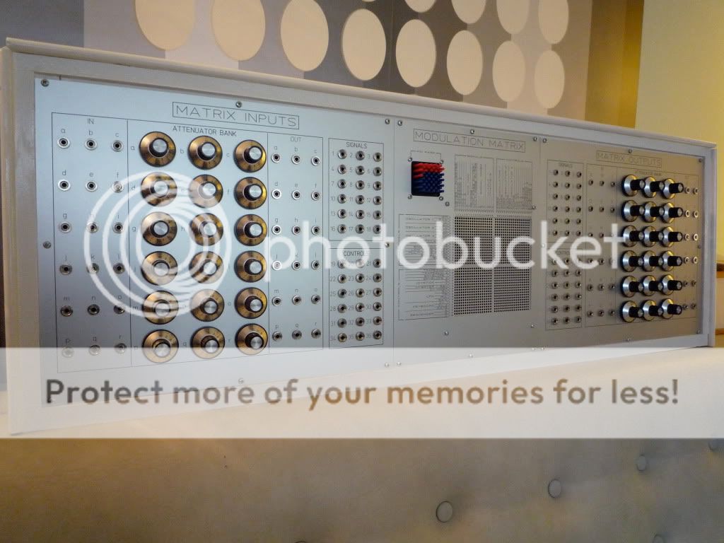

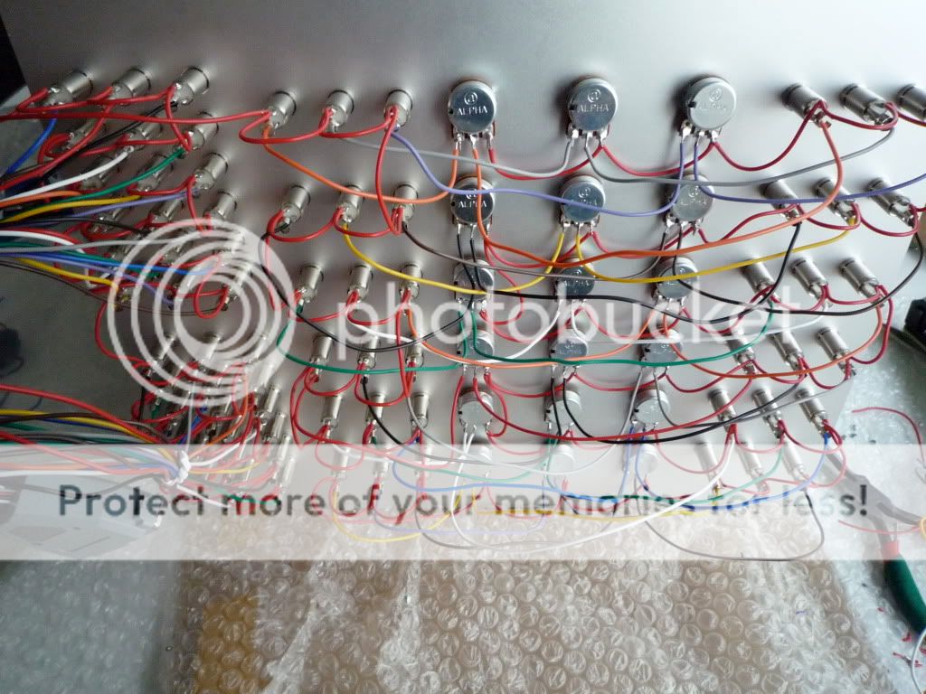

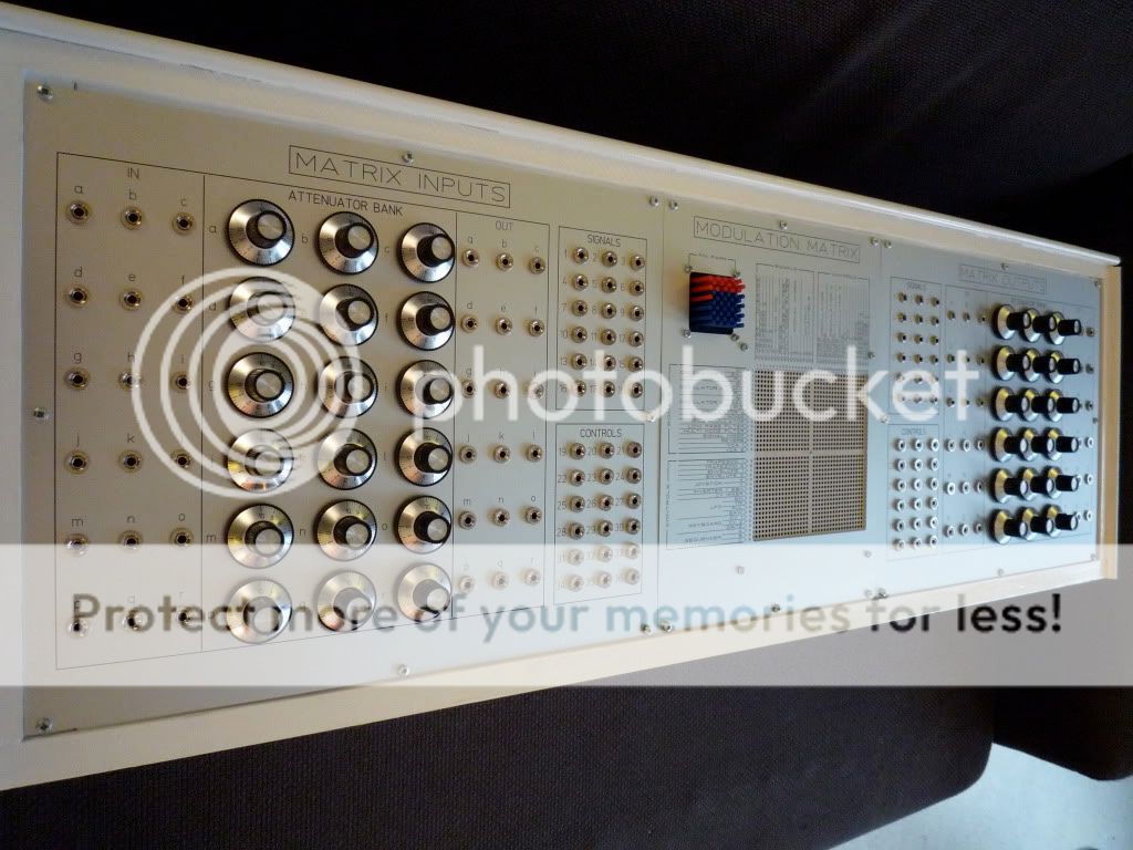

It's been a long time since I've been onto these pages and this is my first time ever post in the DIY section, to present my first SDIY project.
It's a non-buffered modulation matrix based on a Ghielmetti 36x36 and it is to be interfaced with my Eurorack modular.
At the inputs of the matrix, there are 18 passive attenuators (9 Log for audio and 9 Lin for CV ), same thing for the outputs of the matrix.
All attenuators are freely patchable, meaning I can choose to attenuate a signal or not before it enters the matrix, same thing for signals coming out of the matrix.
I've assigned some default inputs and outputs to the matrix rows and columns but this is in no way fixed. This system offers maximum patching flexibility ( on the contrary of module outputs and inputs being hardwired to the matrix, that would imply a fixed configuration)
Of course, any comments, questions, suggestions are welcome !
