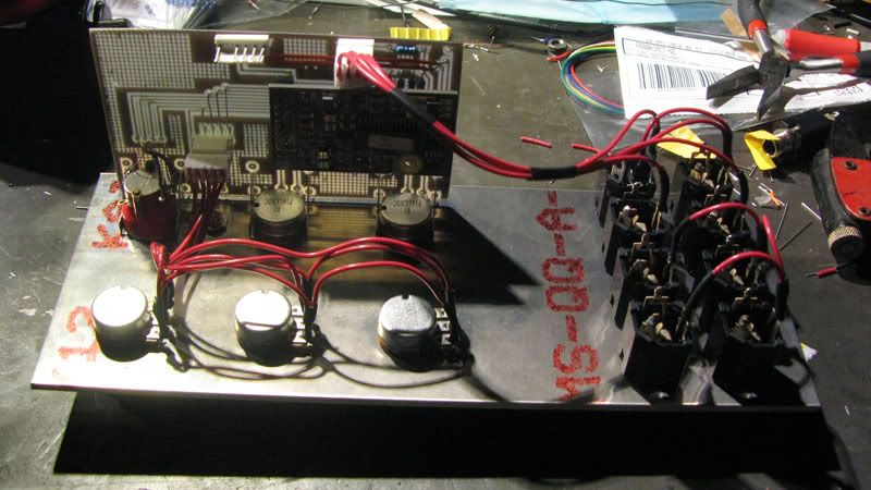

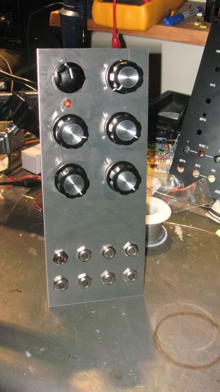

I am going to have a few of these boards made for myself, I was wondering if anyone else will be interested. they would be around $15 - $25 depending on how many people want them.
This is an adapter to use Spin semiconductor FV-1 DSP "SKRM" effects board in a modular.
There are 3 different boards all identical but pre loaded with different effects. the effects are very clean and reverbs can have a long and quite nice decay (although it probably would not beat out a Bricasti M7)
http://www.oct-distribution.com/
those SKRM boards are $27.50 each and they will sell small quantities.
Functions:
Attenuate/limit the inputs with variable controls and clipping indicator.
Boost the output back to +-5v
Switch between the 8 effects. with Grayhill mechanical rotary binary switch,( or you could use 3 toggle switches to save money.)
Each effect can have 3 controls depending how it is programmed, these are the 3 pots on the right
Jacks are in1 in2 (normalled to 1) , out 1 , out 2. extra 4 jacks are a multiple.
Will work on Bridechamber "oops" 2u MOTM panels. or you can buy a blank MU and drill it or whatever, the board is also small enough to use on euro/frac, and I could have both pot spacings on there.
Final board would be double sided with plated through holes, have .com and MOTM connectors, (when using MOTM power the .com connector will have the 5v avaliable for other modules)
maybe small format power as well? i haven't looked in to that. the circuit will have no trouble working at +-12v anyways.
prototype.
Also you can get a FV-1 dev board for $200 or so and write your own effects, and there is an "unofficial, but disclosed by the manufacturer" trick to load them right on to the SKRM EEPROM with the pin header that is already in place.

voltage control of the pot voltage would be easy, however they told me that the voltage is only polled 10 times a second so you could not do audio rate changing of effect values(shame!)
on the good side, when i was listening to it and turning the knobs, i did not hear steppiness.
anyways, I can add voltage control of pot values to the board, and maybe voltage controlled wet/dry mix as well :bananaguitar:

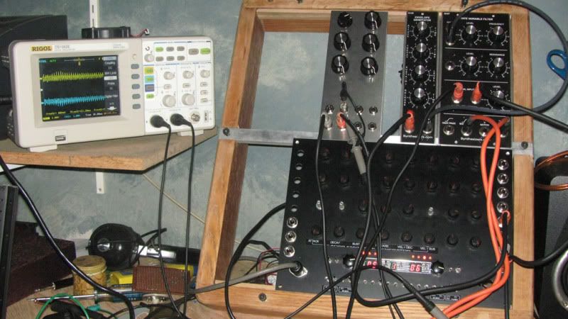

Well i spent the afternoon playing with this, and have noted a few things.
There are no clicks when you speed up and slow down delays, it just warps the sound out of tune until it catches up with itself, like analog :)
There are no clicks when changing programs so one could change programs with voltage control with an lm3915 and a priority encoder, or some other way to make a 3 bit ADC :). (i can add that as an option if the board has enough space)
So far on 2 of the boards, there is no wet/dry mix assigned internally, so the wet/dry can be voltage controlled, as well as "external feedback" (although a lot of programs have internal feedback as well, so things could get a bit hairy if you had both turned up)
Provisionally, I have decided to this to save on panel space, and still be versatile.
2 control voltage bus inputs each with 0-10v or -5+5 switch
each control has 2 switches which enable voltage control from either or both of the control busses.
controllable things
control1
control2
control3
feedback
wet/dry
program change? maybe.
Do people even DIY Euro and Frac? should i bother trying to keep this small enough?
