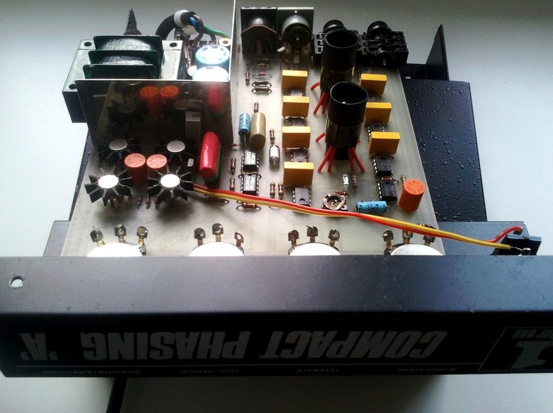

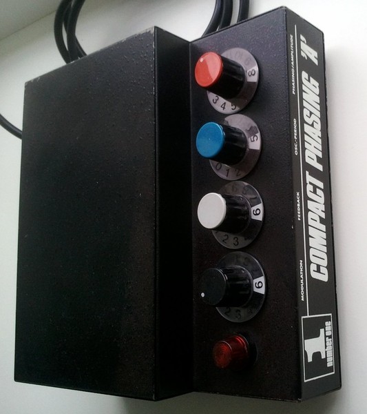

I bought one of these PCBs, indicator lamp, lamp socket, etc from Juergen before he passed away. I still haven't built it-- but will definitely get to it eventually.
I'd really love to have a copy of the Schulte Compact enclosure made. Wouldn't this be great? I know there are stomp box dudes who make custom enclosures and sell them on ebay (like those wedge fuzz boxes and so on). I bet with an order of 10 or so, someone could reproduce this design for a reasonable amount of money.

I think I may have found the fault. I'll find out in the next couple of days when I receive the replacement component.
I went through the LFO section with my multitester. It appears the 110Ω resistor was in fact a 1K (they read 110Ω one way and 1K the other)… Seems the company sent me the wrong value… Could be an expensive mistake, and from now on, any components that read a different value either way will be tested before going into my cabinets.
I have resoldered the 1µF film cap, hopefully this fixes the problem. I'll post back when the new batch of 110Ω resistors arrive
