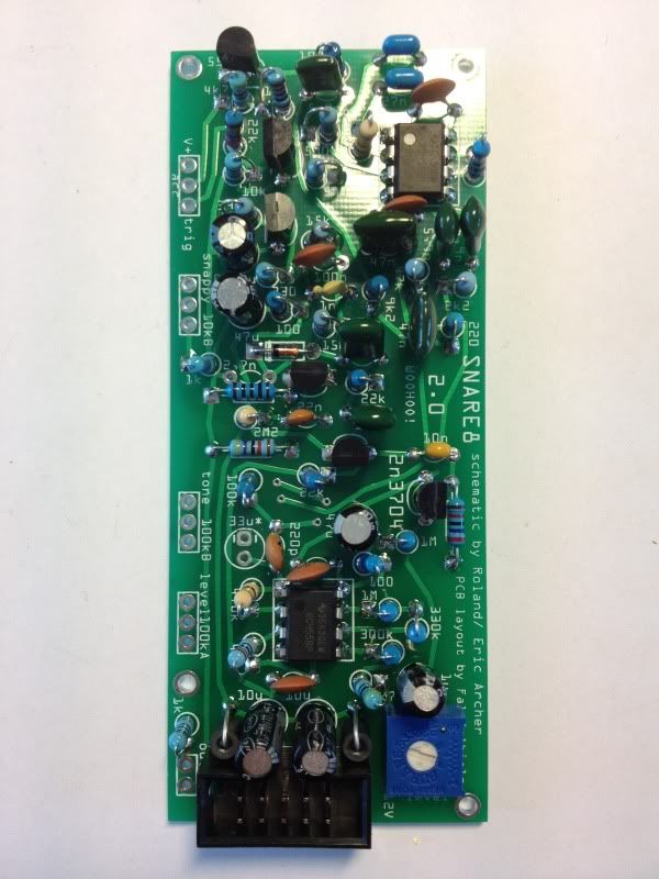

Post by falafelbiels »
Okay boys, if you fill up the voiceboard it should look like this:
But in red...
Notice I left out the 33uF electrolythic capacitor. This is part of the level control and since the level control is not on this board as such (the little lvl pot does something a bit different) it is not needed.

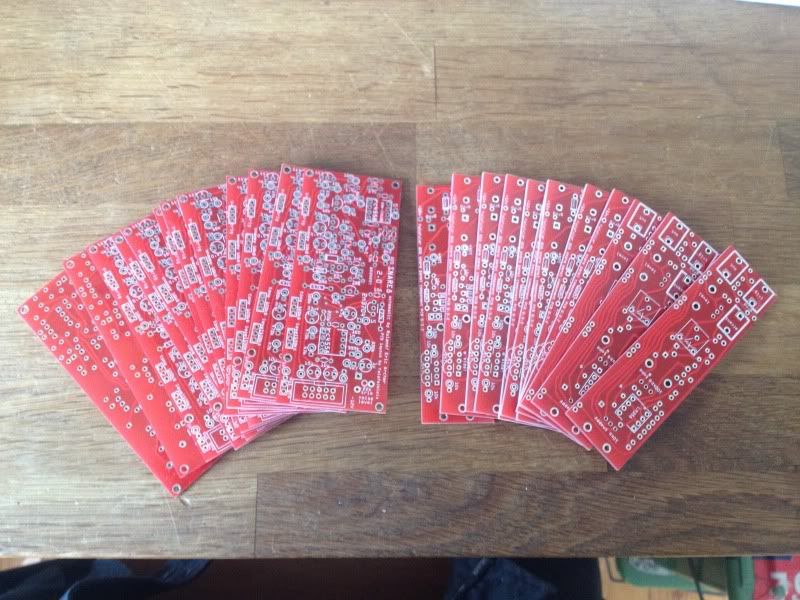

These are the actual PCBs you will be receiving:

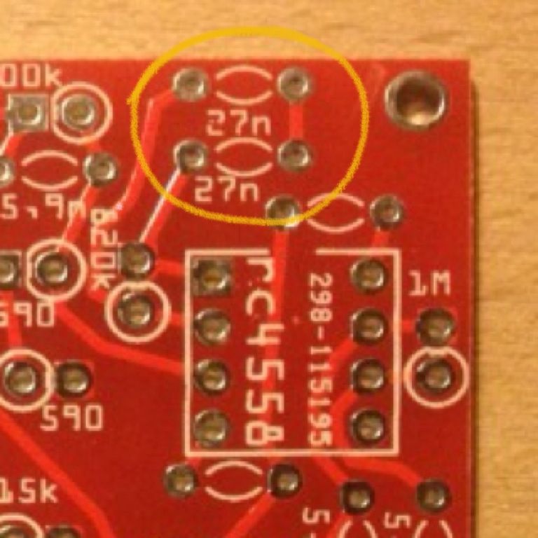

For a bit of a more heavy (lower tuned) sound, replace these 27n capacitors with something a bit bigger. I really enjoy the sound of 47n.
Replacing the 0,47u electrolythic with something bigger makes for a longer decay. 1uf does the job for me fine.
Here's a picture of how the two boards connect, using angled single row pin headers. Please do this last, because it is quite inconvenient to have to still solder in components after this. note that the "level100kA" pinholes are not used. don't solder in a pin header there!
