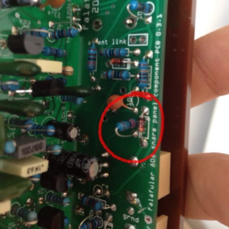

falafelbiels wrote:This here is the schematic for the panelcomponentboard, you may need it.
Some values are different on the PCB, like 8k2=10k...
Pd is for pulldown (100k) and bypass caps are left out in the schematic.
Acc in isn't really normalled to 12v, it used to be in an earlier version.
The pot is the little plastic shaft one. The other pots are in the main board schematic, which is the one by Eric Archer found here
Ah, thanks for the schem. Found it. I didn't jumper Rx.

Works then?
qp
Posts: 526
Joined: Sat Apr 27, 2013 4:58 pm
Location: United States
Post by qp »
falafelbiels wrote:Works then?
The accent input does. I can hear a subtle difference with the tone, but I'll wait on the 100k pot before I look more into it. Besides, I'm off for vacation soon, so it'll sit for a bit anyway.

Try lowering the value of the standing resistor, it should give you a lower low level on the pot and thus bigger dynamic range. I think I used 100k for it but I can't think of a reason why. Should be more like 10k.
qp
Posts: 526
Post by qp »
It's rockin a 10k already. If I have time tonight I'll swap it with a 1k and see what happens.

I see that I made a pic of a earlier revision board there...
