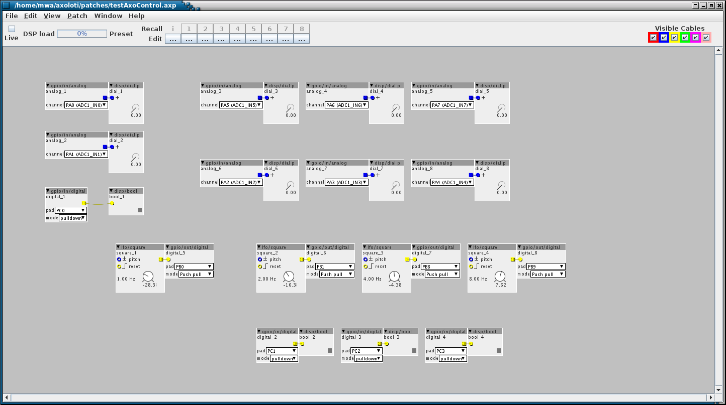

Ah, of course I have the ksoloti objects! there just (still) called noloti :) And the mapping I meant is vis. my old wrapper objects, one for the old axo control layout (with a couple of modifications) and one custom one. There I had to make a new version and use the new 'noloti' gpio objects.
EDIT: This is the old axo control object which I had to edit , not such a big deal.
EDIT: AND it all 'just works' :)
That's great! Looking at the patch there really isn't anything that needs changing.
So far the only situation where edits are needed is when an object relies on any of pins PC0, PC2, PC3. Those are not available on Ksoloti as they are used by the SDRAM. You can just use some other GPIO on the Ksoloti. For example if your old hardware used any of those three PC* as analog inputs you can use PF6...9 instead.
For future patching it is safe to use the ksoloti/gpio/*** objects because you can't select any wrong pins there.
