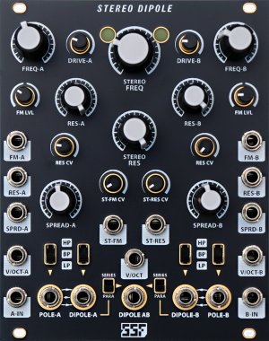

The new SSF Stereo Dipole black and gold panel is looking fantastic!
https://www.modulargrid.net/e/steady-st ... k-and-gold
